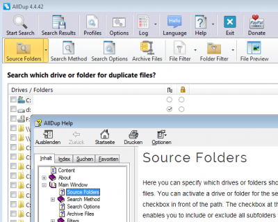

Thanks, I understand now. But there's also "Remove all groups with files not exist in all source folders" under Search Options.
What exactly does this option filter out?

This option is useful when you search multiple source folders and some files not exist in all source folders.
Re: Meaning of "Remove all groups containing only files stored in archives"?
Don't understand the bolded part. The only reference to the concept of "source folder" is under Comparison Method.Administrator wrote: ↑07 Dec 2020, 12:54 This option is useful when you search multiple source folders and some files not exist in all source folders.
Is it safer/best to "Compare files from all source folders" and don't "remove all groups with files not exist in all source folders"? safer that users don't miss any dups.

What does "some files not exist" means? the manual doesn't have any explanation of this option.
For instance, if a pair is in different sub-folders, does this option filter out the match?
Should I leave it un-checked?

Example:
you search the source folders AA, BB and CC and a group contain only files from the source folders AA and BB: this group would be removed.
