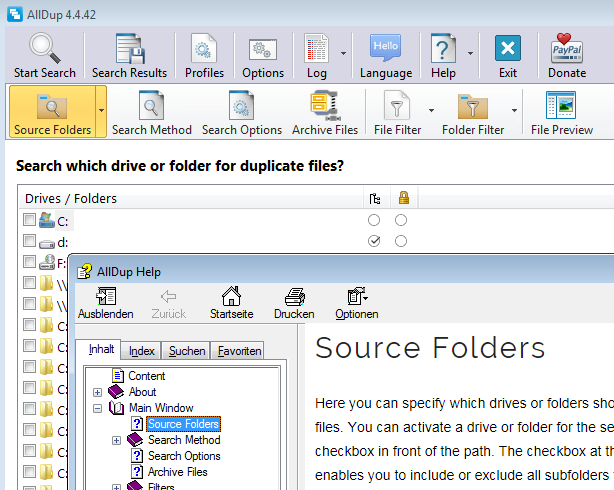

Administrator wrote: 07 Dec 2020, 12:54 This option is useful when you search multiple source folders and some files not exist in all source folders.
Don't understand the bolded part. The only reference to the concept of "source folder" is under Comparison Method.
Is it safer/best to "Compare files from all source folders" and don't "remove all groups with files not exist in all source folders"? safer that users don't miss any dups.
mz1888
Posts: 35
Joined: 24 Jul 2019, 14:00
Re: Meaning of "Remove all groups containing only files stored in archives"?
Post by mz1888 »
What does "some files not exist" means? the manual doesn't have any explanation of this option.
For instance, if a pair is in different sub-folders, does this option filter out the match?
Should I leave it un-checked?
Posts: 4123
Example:
you search the source folders AA, BB and CC and a group contain only files from the source folders AA and BB: this group would be removed.
