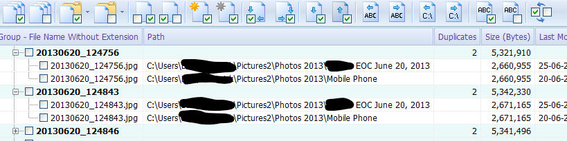

3) After the search is complete and the duplicates are listed, is there a way to group the same folders together when many duplicates are always out of the same folders?
e.g. file1 found in foldera and folderb; file2 found in the same two folders. List these two files in the same expanding group, as their folders are the same.
The advantage is that to select which file/folder to keep would be much simpler as I would keep the files from the same folder in these cases.
See attachment for example.
