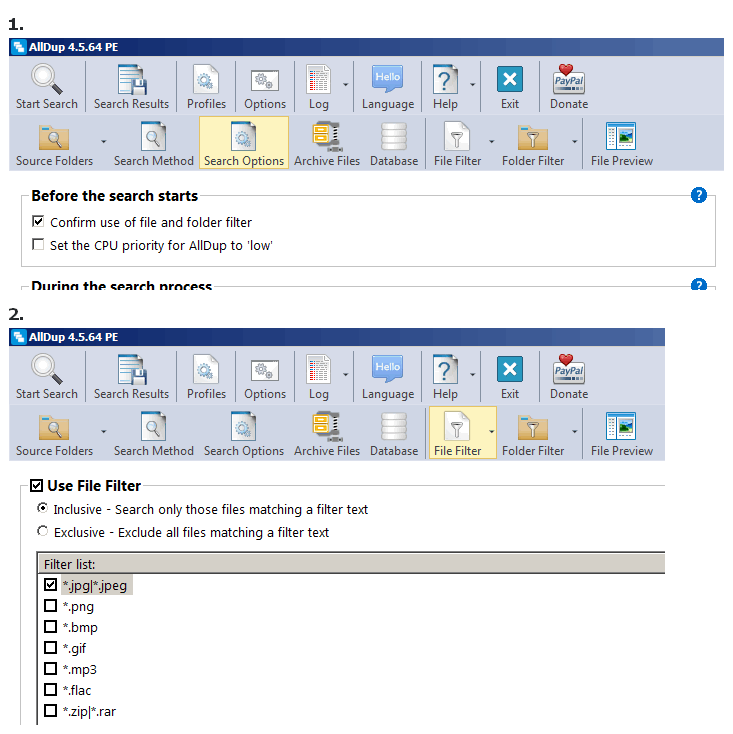

You're saying that enabling 1, causes both Inclusive & Exclusive to become enabled in 2?

therube wrote: ↑13 Nov 2024, 00:38 You're saying that enabling 1, causes both Inclusive & Exclusive to become enabled in 2?
Damn, I got it!
Thank you so much Therube!
I was missing THAT ONE checkbox!
I probably unchecked it accidentally and then I didn't "see" it anymore, and so later when I was looking at that little square it seemed to me a simple graphic element without any importance!
What a fool I've been!
Furthermore, when the Administrator first told me to select the "Use file filter" checkbox, I misunderstood.
I thought he was referring to "Confirm use of file and folder filter" in the Search Options tab!
I'm so sorry for wasting both of your time, and I'm so very grateful to both of you for helping me understand my mistake!
Before this episode I was already thinking about making a PayPal donation because I've tried many duplicate search software and found that AllDup is the best one...
Now I won't wait any longer and I'll make the donation!
Thank you so much!
