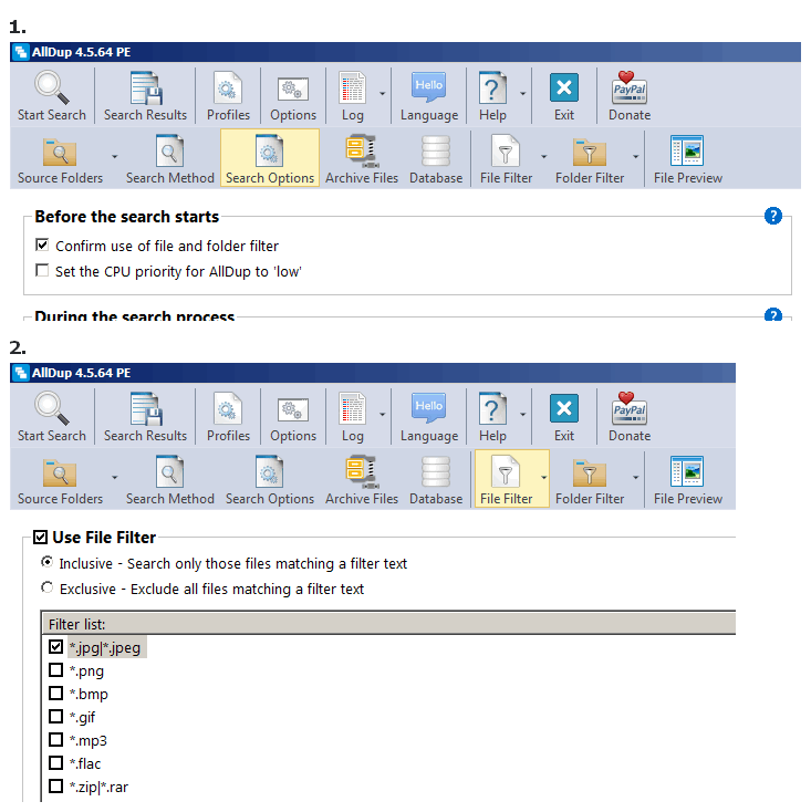

I noticed a strange behavior of my AllDup that I do not understand:
when I activate the checkbox of a certain filter, for example in the "Inclusive" tab, it is automatically replicated also in the "Exclusive" list.
For example if I check the default filter "*.jpg" in the Inclusive tab the checkbox is also replicated in the Exclusive tab...

You're saying that enabling 1, causes both Inclusive & Exclusive to become enabled in 2?

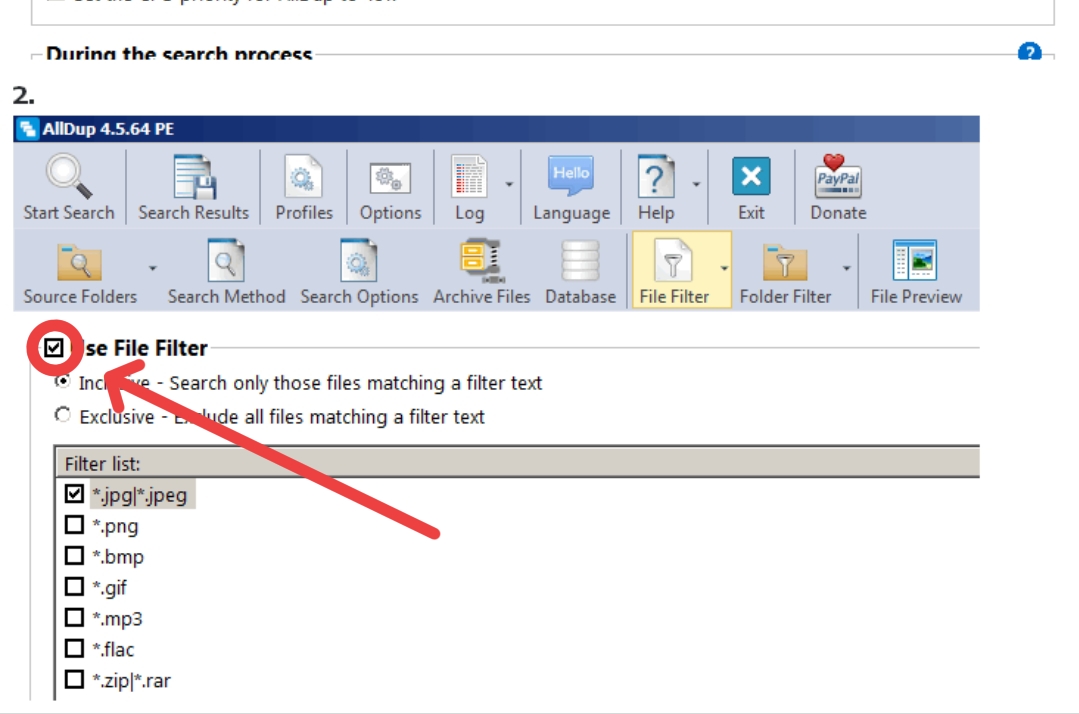

Quick help - How to scan only png files:
1. activate the "Use File Filter" checkbox
2. activate the "Inclusive..." radio button
3. activate the "*.png" filter checkbox

therube wrote: 13 Nov 2024, 00:38 You're saying that enabling 1, causes both Inclusive & Exclusive to become enabled in 2?
Damn, I got it!
Thank you so much Therube!
I was missing THAT ONE checkbox!
I probably unchecked it accidentally and then I didn't "see" it anymore, and so later when I was looking at that little square it seemed to me a simple graphic element without any importance!
What a fool I've been!
Furthermore, when the Administrator first told me to select the "Use file filter" checkbox, I misunderstood.
I thought he was referring to "Confirm use of file and folder filter" in the Search Options tab!
I'm so sorry for wasting both of your time, and I'm so very grateful to both of you for helping me understand my mistake!
