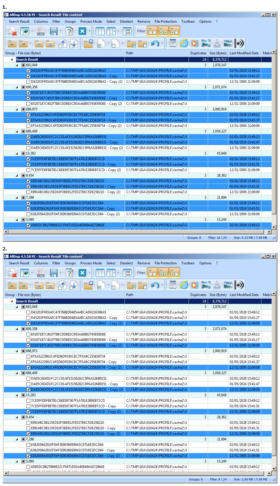

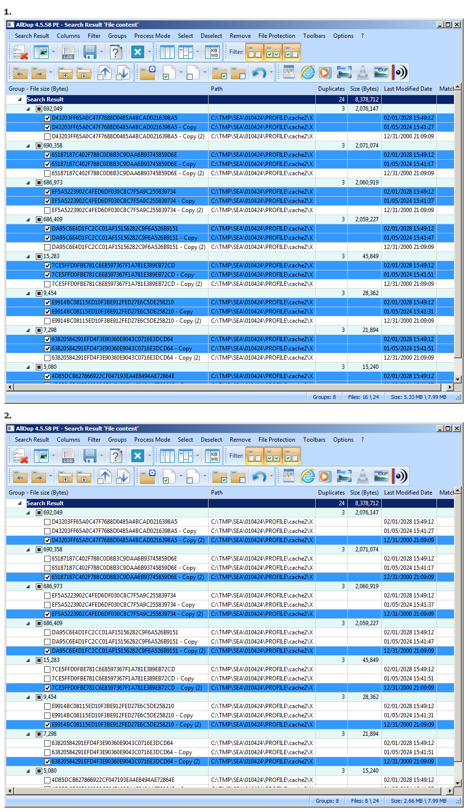

1. date, newer, 2 days
2. date, older, 2 days

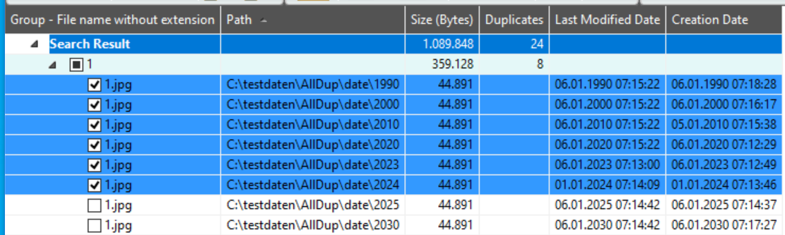

i still cant reproduce your problems:
older than 2 days:

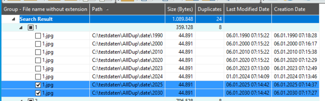

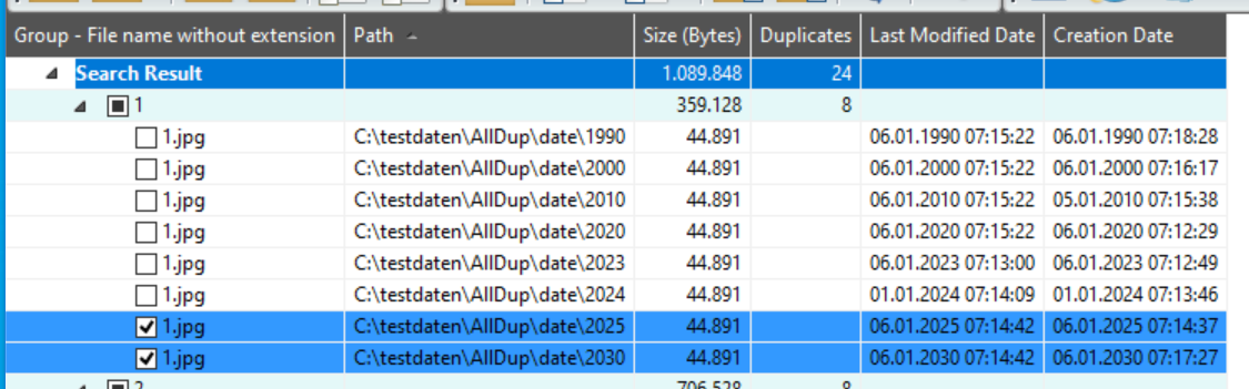

newer than 2 days:
