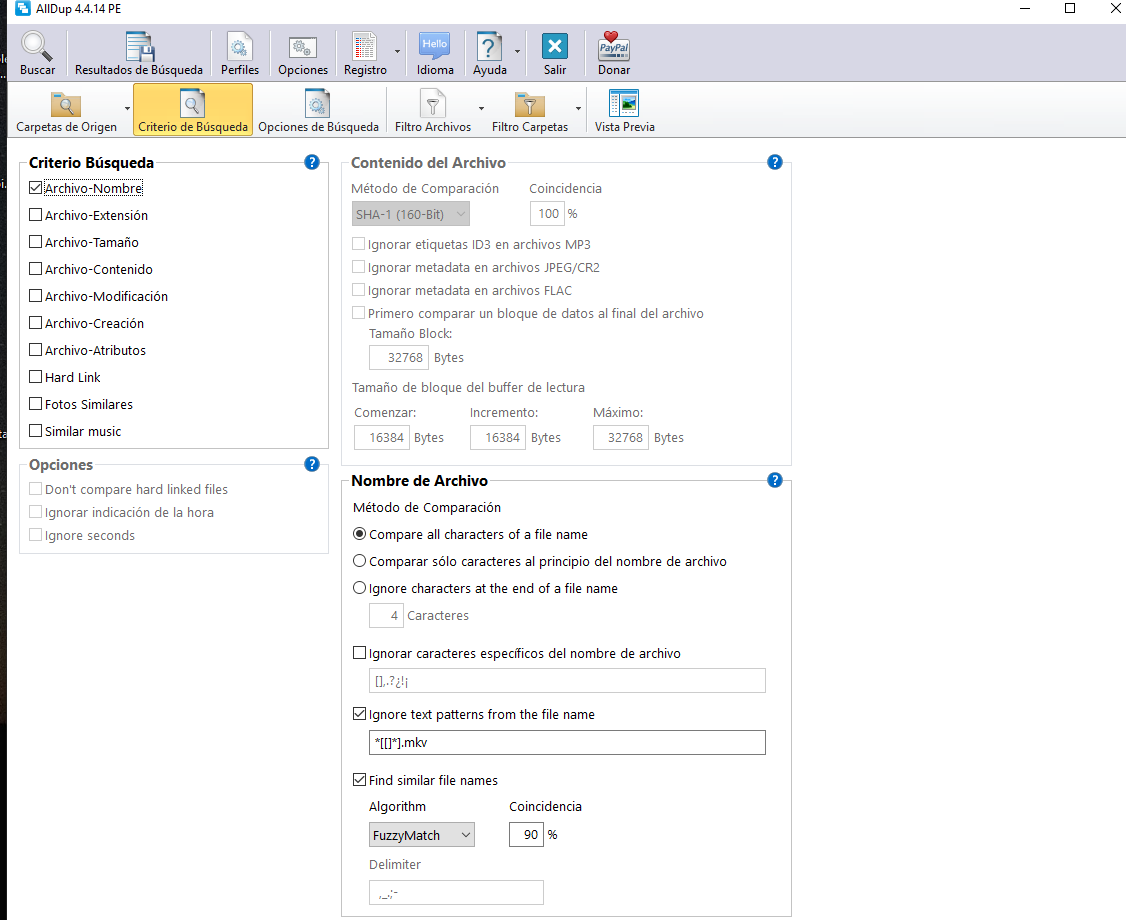

i attached image for your supervision for alldub all files are uniques
sorry. i wrote wrong the command in the forum
i try *[[]*].mkv
- Posts: 4139
Re: How to do it
We used the select command "Select files by name" with the pattern "*[[]*].mkv"...
You cant use this search pattern with the file name option from oyur screenshot.
