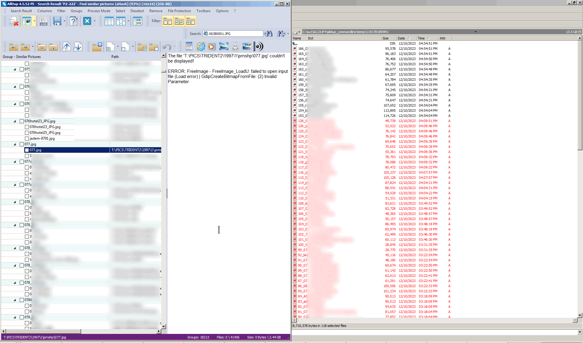

"the file ...014_0014.jpg couldn't be displayed!
ERROR: FreeImage - FreeImage_LoadU: failed to open input file (Load error) |
GdipCreateBitmapFromFile: (2) Invalid Parameter"

but when i landed on the 2nd 'group', the "group" thumnail displayed:

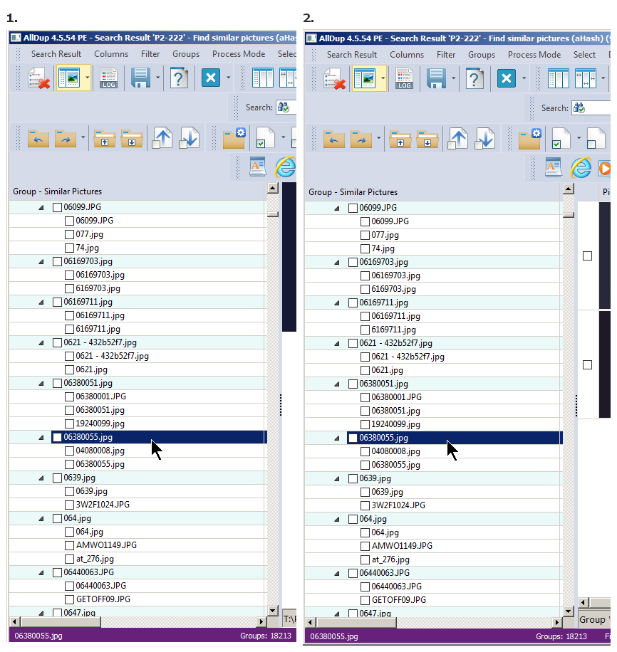

< ---attach picture--- >
1. File Preview is displaying a picture (rather then thumbnails)
(it would be 'A' picture from the prior Group, not necessarily the "last" picture in that group)
[now, in this case, i didn't actually pay attention to what picture was shown, only that it in
fact showed a picture rather then thumbnails]
2. File Preview - now displays the thumbs - after having (single) left-click on the Group
(or i could have arrow-key down [or up] & back to the group, & that would have "fixed" it)
again, not a big deal, but something is not quite right.
(so just keep it in mind, for the time that you happen to run into it
(for the screenshot, I reduced the window size [which also did not affect what was displayed in Preview]
though ordinarily the window size is set to fullscreen [maximized])

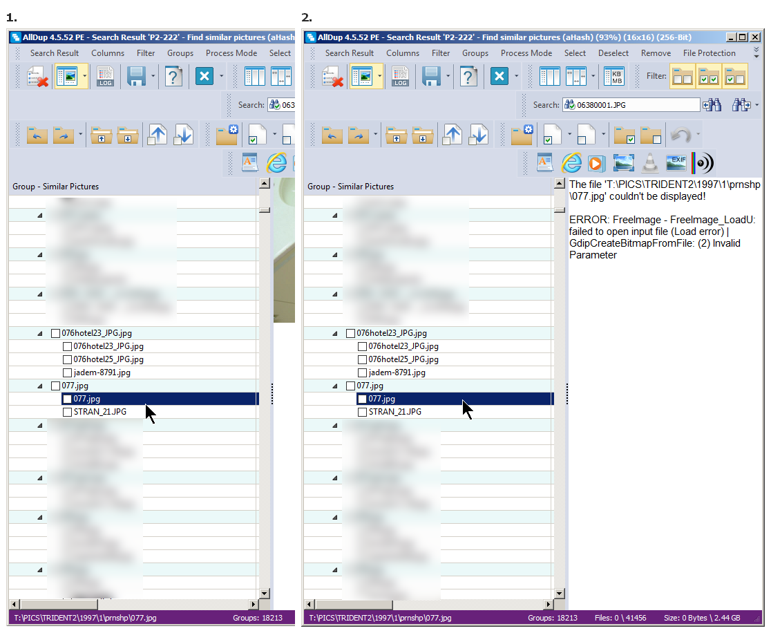

5.52 ALSO does it !!!
& this time, it was a /FILE/, rather then a GROUP, where the mismatch occurred
in the case of .52, i looked at the 076hotel Group & saw that none were dups,
& knowing that, i arrow-key'd down, quickly, & happened (in doing so) to "bypass"
the 077 Group, landing on the 077.jpg File, & that 077.jpg file was actually
displaying 076hotel23's image. & once again, simply single-click (again if you will)
on 077.jpg (file) then showed (pic #2) the "correct" file thumbnail (which in this
particular case happened to no longer exist - hence the "error" [expected])

Re: Image Preview, Group view, does not always
1. is showing a file (in the Preview section)
2. is showing Group thumbs (in the Preview section) 1. 077.jpg is actually the file ...hotel23 (in the Preview section)
2. is showing the correct "ERROR" message after having left-clicked on the 077.jpg filename (in the Preview section) AllDup (& Servant Salamander displaying) /temp/GUID/ directory, showing thumb generation break, jumping from 128 to 153.

of my current .asr4a & number of items therein
is (now) making this more apparent,
rather then a particular AllDup version ?
perhaps ? size matters ?
the size of the pictures, so on larger pics it takes longer to generate
the thumb & if you move "quickly" between pics (on the detail side, not
the thumbnail side), by the time it has finished rendering the (what is
now, previous) picture, you are already on the next (be it file or group)
& with that, "some" earlier thumb ends up getting displayed - at that point
& regardless of what the actual file/Group you may have focused on
&, that might also be where that single left-click plays in, that with an
incorrect thumb being displayed, that left-click then "sets" (& even
though nothing else was changed) focus, again, to a particular item
& that item has (now) fully loaded (its' thumb) & so (then) displays, correctly ?
Win7 i5-3570k 16GB RAM intel HD Graphics 4000 video (on cpu)
