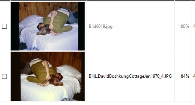

It's having a tough time.
Tried a different program & it too wasn't particularly successful.
aHash, 83%, entire picture, 16x16, & Detect picture modifications (all enabled)
With that, it finally found Bild0019.jpg & BillL.DavidBoshkungCottageJan1970_4.JPG as "dups".
But then, it also found a different set of non-dups as dups.
I was not able to get Bild0014.jpg & DadWyomingRoadTripJul70_1.JPG to be seen as dups.
Oddly, Bild0003.jpg & Bild0007.jpg were often noted as "dups".
(I'm not particular proficient in picture dups, but I've been dabbling of late. With what I've been going though, I dropped the % to 93%, & that seems to be low enough to pick up wanted items while also returning relatively few false dups. If I dropped down to 83%, I'd guess I'd be in the realm of mostly false dups.)

i got this results with mHash:
Comparison method: mHash
Match: 80%
Detect picture modifications: Flipped horizontally
