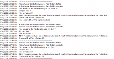

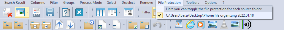

I've tried to change the protection mode with the Drop down in the File Protection mode, but it will not change the protection designation to let me delete the selected files. I have tried it with the check mark AND without the check mark. How do I fix this?

The checkmark indicates that the file protection is ON.
Remove the checkmark to turn OFF the file protection for a source folder.

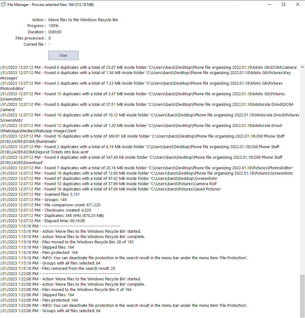

Post your log.

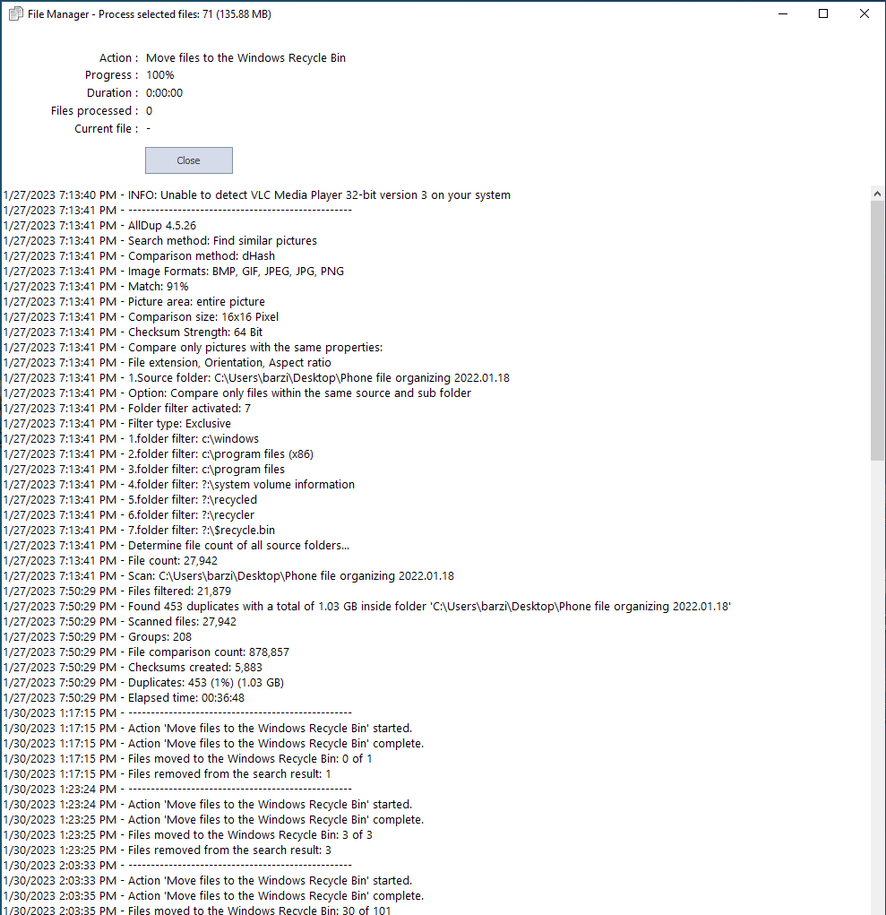

Unfortunately saving exiting and restarting did not work.

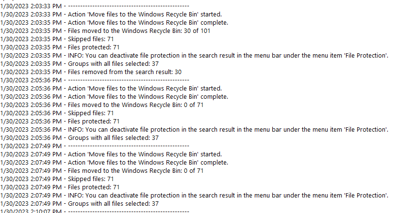

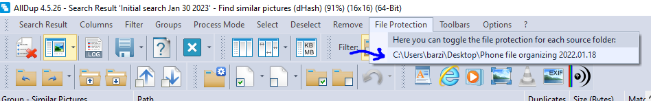

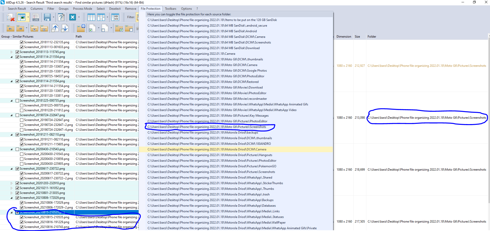

I'm wondering if it has to do with the "Main" search file and the "sub-files". I searched the main file and all sub-files. It seams like it deleted the pictures in the main file, but won't delete in the sub-files. If that's the case, is there a way to "un-protect" the sub-files post search? When in the File Protection pull down, I only get the main folder listed (per the attached pic). So I can't un-protect anything but the main file.
Thoughts?

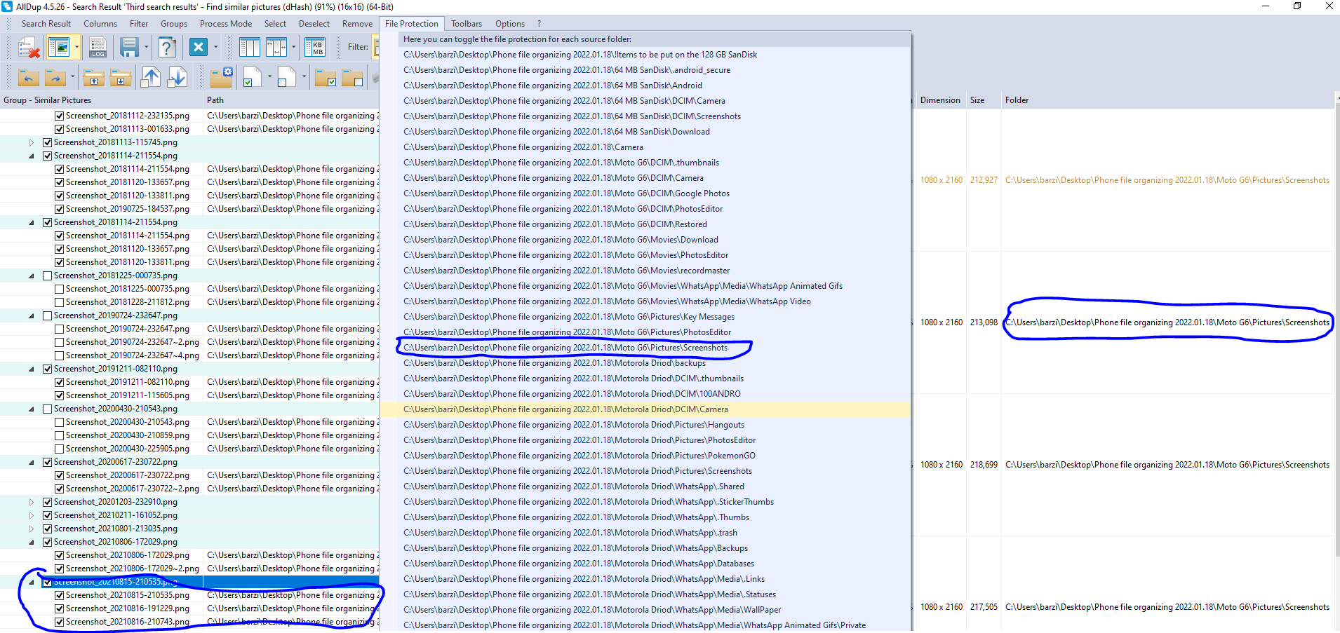

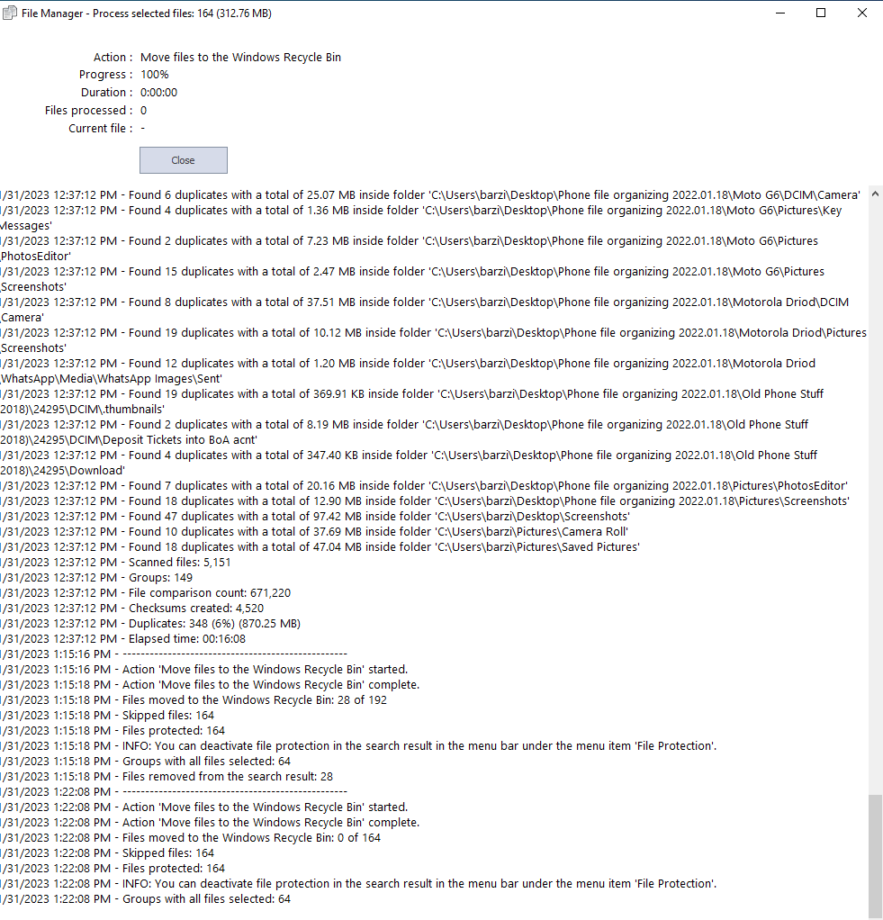

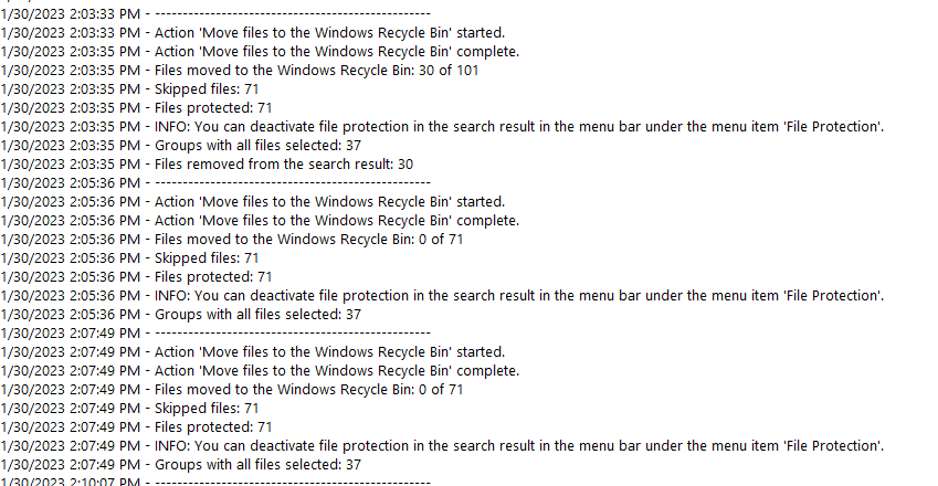

I've run another search and this time, from the beginning added the other files to be able to select/deselect as protected. per the attached pic, you can see the pathway of the picture is the same as the pathway that shows a fold that is unprotected, yet it will not delete the file. I've also attached the log.
Any help to trouble shoot this would be appreciated.

Protecting or unprotecting a source folder includes all files in the sub-folders too.M_Barz wrote: 01 Feb 2023, 01:20If that's the case, is there a way to "un-protect" the sub-files post search?
There is no need to add all sub-folders of the source folder to the source folder list.

06/10/2025 19:55:53 - INFO: Unable to detect VLC Media Player 32-bit version 3 on your system
06/10/2025 19:55:54 - --------------------------------------------------
06/10/2025 19:55:54 - AllDup 4.5.26
06/10/2025 19:55:54 - Search method: File name
06/10/2025 19:55:54 - Comparison method: Compare all characters of a file name
06/10/2025 19:55:54 - 1.Source folder: C:\Users\User\Desktop\Cloud Backups\Centralized All Docs
06/10/2025 19:55:54 - Option: Compare files from all source folders
06/10/2025 19:55:54 - Determine file count of all source folders...
06/10/2025 19:55:55 - File count: 7,255
06/10/2025 19:55:55 - Scan: C:\Users\User\Desktop\Cloud Backups\Centralized All Docs
06/10/2025 19:55:57 - Found 3,060 duplicates with a total of 17.45 GB inside folder 'C:\Users\User\Desktop\Cloud Backups\Centralized All Docs'
06/10/2025 19:55:57 - Scanned files: 7,255
06/10/2025 19:55:57 - Groups: 1,163
06/10/2025 19:55:57 - File comparison count: 7,255
06/10/2025 19:55:57 - Duplicates: 3,060 (42%) (17.45 GB)
06/10/2025 19:55:57 - Elapsed time: 00:00:03
06/10/2025 19:56:45 - --------------------------------------------------
06/10/2025 19:56:45 - Action 'Delete files' started.
06/10/2025 19:56:45 - Action 'Delete files' complete.
06/10/2025 19:56:45 - Files deleted: 0 of 9
06/10/2025 19:56:45 - Skipped files: 9
06/10/2025 19:56:45 - Files protected: 9
06/10/2025 19:56:45 - INFO: You can deactivate file protection in the search result in the menu bar under the menu item 'File Protection'.
06/10/2025 19:56:45 - Groups with all files selected: 1
