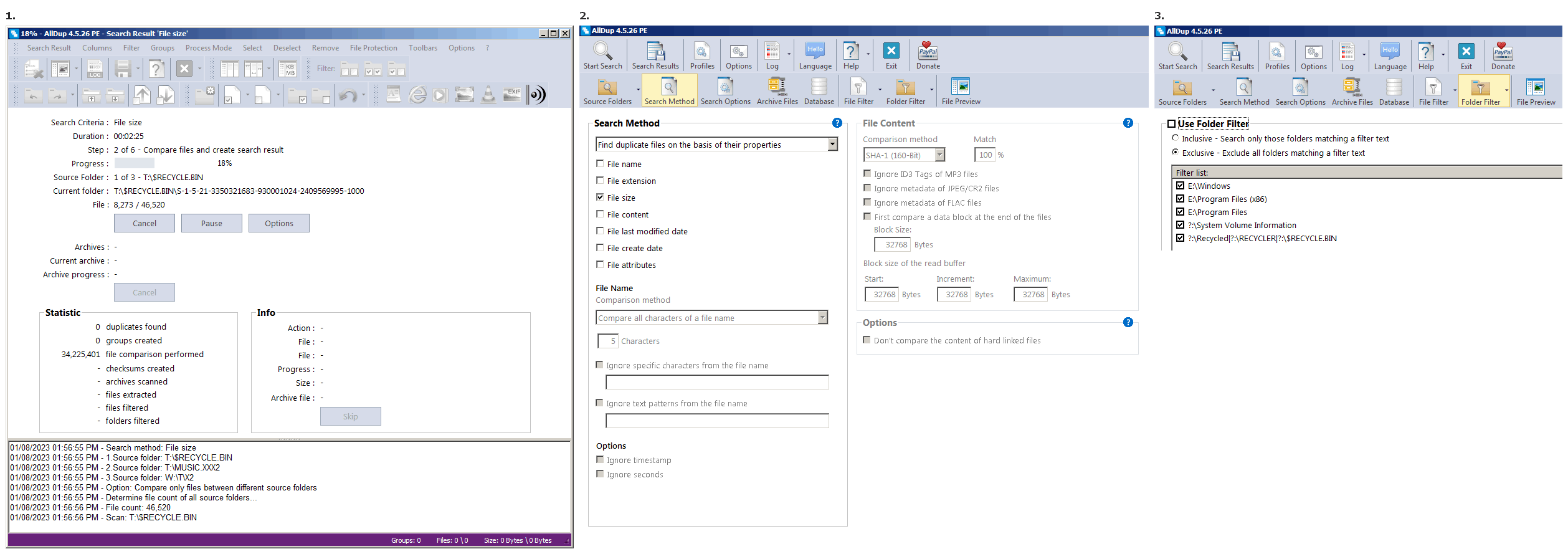

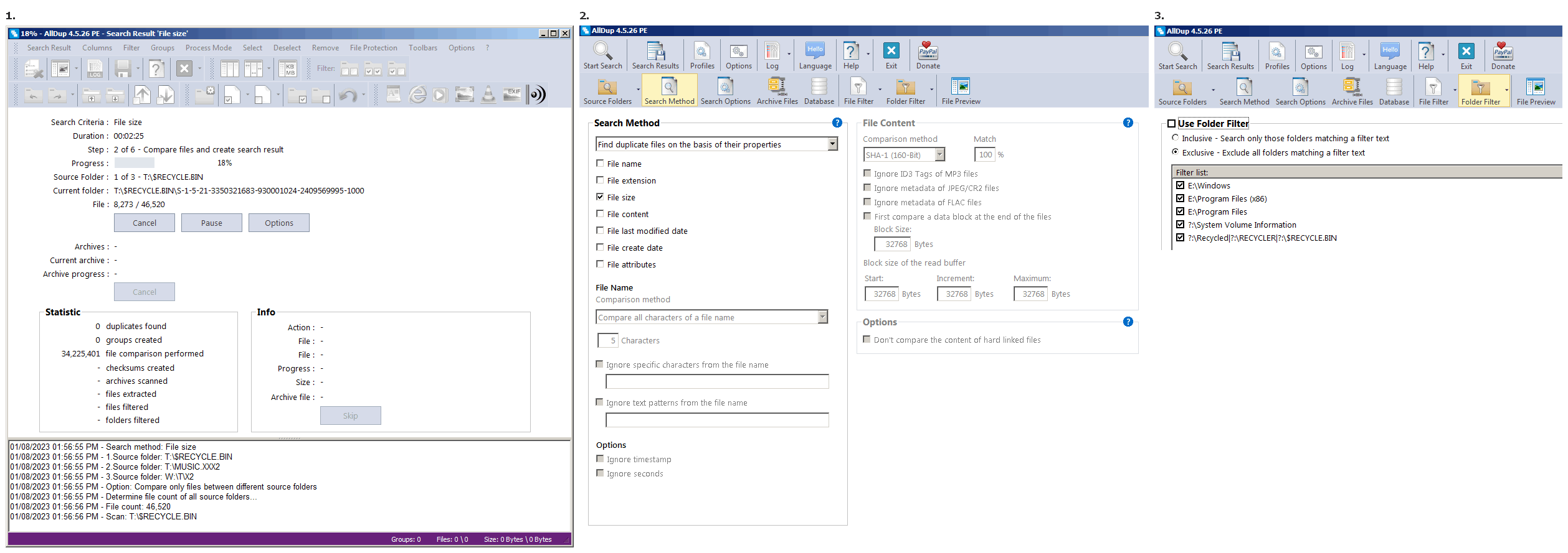

(I forgot the screenshots. I'll see if I can't get them here tomorrow or so.)
Posts: 345
Re: Slow with Compare Between Different Folders

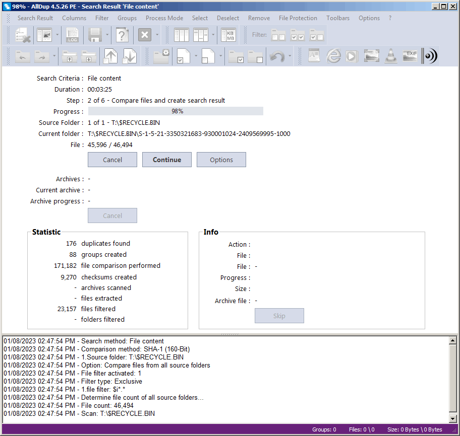

Note the 'file comparison performed'.
And in the first shot, seemingly that is (ongoing, as I cancelled it &) before anything else were to happen.
Second shot, I added an Exclude filter of $i*.* (which for $recycle.bin, excludes those [irrelevant] 544-byte files).
While that is a lot less files, there are still a lot of files, overall.
And in any case, 544 bytes would not match anything outside of $recycle.bin itself, & as the compare setting was (originally) 'Compare only files between different source folders', that in & of itself should have excluded those 544-byte files, I would think.
