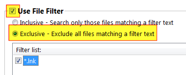

How do I Filter out shortcuts from the Search Results. What wording or syntax should I use. I have tried *.-shortcut, *.-shortcut.lnk, *.shortcut and *.shortcut.lnk and none of them work

use: *.lnk

That still gave me shortcut link in the search results

by Administrator
Screenshot - 12.05.2022 , 15_27_42.png (5.37 KiB) Viewed 9441 times

Thanks, I finally noticed in your picture that the Use File Filter had a box that needed to be checked. When I checked it, it worked just fine.
