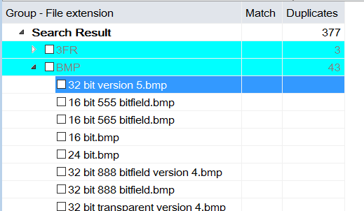

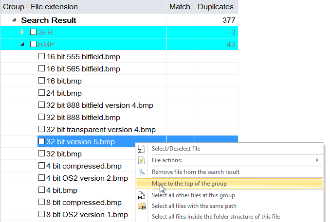

We added a new file context menu command:

Result:
Screenshot - 25.06.2021 , 07_42_48.png (10.33 KiB) Viewed 16866 times
