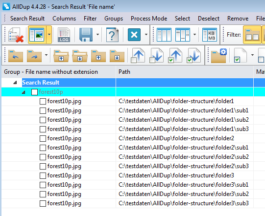

The sorting of the path column works fine:

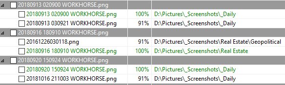

However, in reality, similar dups come in this way: It makes me wonder how the comparison is done because % similar is non-directional. So is it up to the sequence of discovery aka ascending folder structure?? Thanks.

What column was sorted at your screenshot?
Re: Search Result Grouping Enhancement
I sorted by path asc or desc, same issue.

I still dont understand what is wrong with sorting at your screenshot?
It jumped from sub1 to sub2, then back to sub 1. It's expected when sorting by path, it goes sub1 then sub2 and not back again.
From your screenshot, the ascending ordering on the path is hierarchical thus correct, when the file names are identical.
From my screenshot, it shows path sorting is disrupted i.e. non-hierarchical when filenames are dis-similar. The only way this makes sense is that AllDup aggregates all files in one list ordered by filename, look up similar files sequentially, and dumps the output as is. And the path ordering is done within the grouping, not between the grouping.
If sorting by path is working as perceived by average users, we'd see sub-folder hierarchy: 0, 1, 2,....,n-1, n, not 0, 1, 3, 1,...n.
It's not exactly a flat list. If you sort by group, it will sort by the filename referenced by the group. However, if you sort by path, only the path within the group would change and the groups would remain unchanged.
Is it possible to add tree view as an additional feature? introduce additional grouping on top of the filename grouping, or, allowing moving path column before the filename.

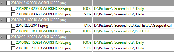

I'd like to pull this up again. Actually there is no chance to sort the whole result table by path.mz1888 wrote: ↑02 Jun 2020, 08:50 Yes that's a very ideal case where it works.
As shown in the screenshot there are three groups. Sorting by path-column should also change the order of the groups. So the total list could be examined and inspected in path order.
Example (nearly the screenshot):
Group 1
\a\a
\a\a
Group 2
\a\b
\a\b
Group 3
\a\c
\a\a
Group 1
\a\a
\a\a
Group 3
\a\a
\a\c
Group 2
\a\b
\a\b
