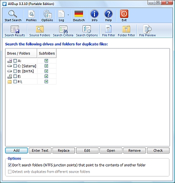

I don't know if there is a way to specify source folders without using folder filter.
Maybe i'm doing somenthing in the wrong way....
I got it, :oops: looking at the following image found on Internet, i've just realized there is probably a way to add a folder directly in source folders tab....
Ok, anyway, i think there is still the problem with folder filter.
If my source drive is S and i enabled option to search in subfolders and added a filter to search in 4 subfolders, at least, it should search in those subfolders and find the duplicate file.
It instead tells me the search was in ONE folder, only one.... Wich one?
In the more relaxed case, it could search in the whole drive (ignoring the folder filter because it includes 4 dirs already part of the source).
Am i Right?
Thanks
Daniele

How to simplify things at this case:
Just add your 4 folder filters as source folders and deactivate the folder filters.
More complex solution if you want to use S: as a source folder only:
Add every subfolder-path of your folder filters to the folder filter list like this:
S:\DanyToCheck
S:\DanyToCheck\Applications

Administrator wrote:How to simplify things at this case:
S:\DanyToCheck
S:\DanyToCheck\Applications\Admin Utility
mmmmm, :roll: the second alternative do not solve completely the issue:
if i do not want to search in the first two levels of tree, it force me to add them anyway. That's not the solution.
I think to correct the issue in AllDup, it should take care of the dirs added in the filter and only of them.
Thanks a lot for your answer, i'll follow the simplest way, adding the 4 folders to source folder.
Have a nice day.
