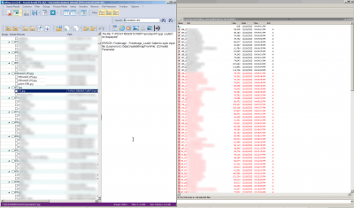

"the file ...014_0014.jpg couldn't be displayed!
ERROR: FreeImage - FreeImage_LoadU: failed to open input file (Load error) |
GdipCreateBitmapFromFile: (2) Invalid Parameter"
now, all of that is fine & expected
- but it was not expected that that message displayed when i was on a Group
entry, not (any longer) on the file
^-that is just as it happened to happen, & i'm not saying that "error" played
into what happened, necessarily, it just happened to be what happened at the
time (& again, that the error existed was completely expected [as beforehand
i had renamed the file - outside of AllDup]

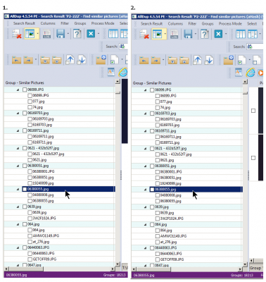

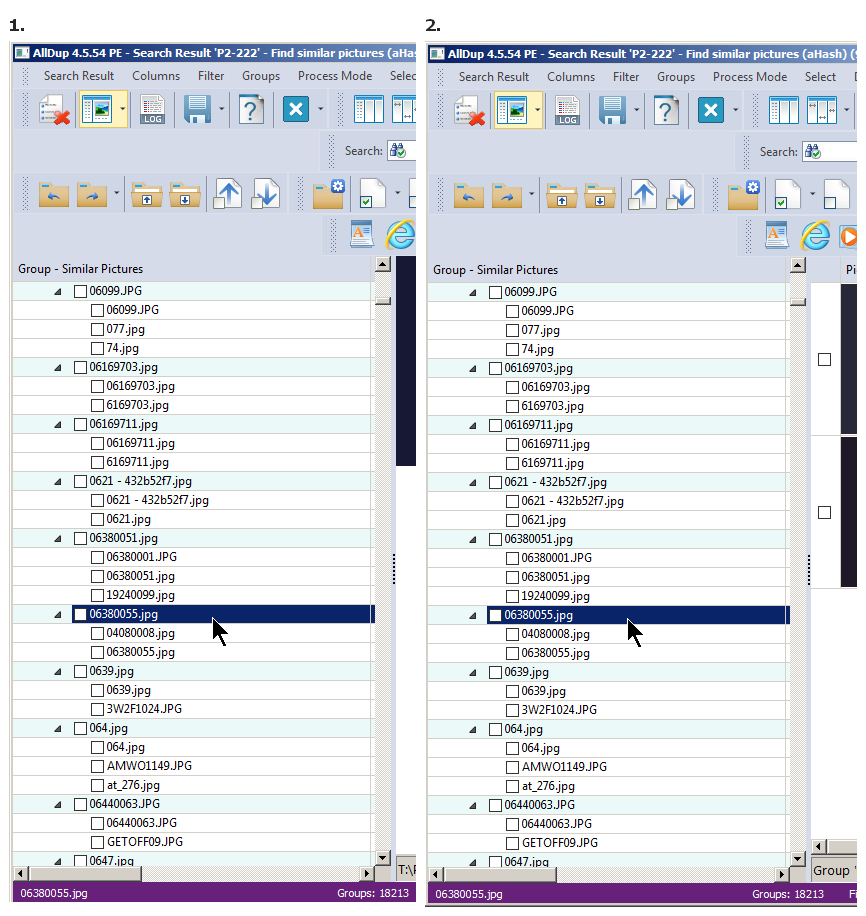

< ---attach picture--- >
1. File Preview is displaying a picture (rather then thumbnails)
(it would be 'A' picture from the prior Group, not necessarily the "last" picture in that group)
[now, in this case, i didn't actually pay attention to what picture was shown, only that it in
fact showed a picture rather then thumbnails]
2. File Preview - now displays the thumbs - after having (single) left-click on the Group
(or i could have arrow-key down [or up] & back to the group, & that would have "fixed" it)
again, not a big deal, but something is not quite right.
(so just keep it in mind, for the time that you happen to run into it ;-).)
(for the screenshot, I reduced the window size [which also did not affect what was displayed in Preview]
though ordinarily the window size is set to fullscreen [maximized])
Win7, x64
& i do not have any "Windows Aero" theme enabled, in case that should matter
(it has, at times, with other programs [including Mozilla Firefox])

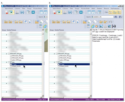

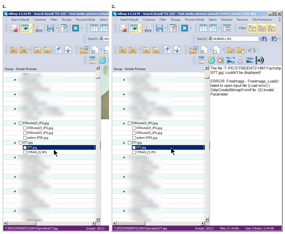

5.52 ALSO does it !!!
& this time, it was a /FILE/, rather then a GROUP, where the mismatch occurred
in the case of .52, i looked at the 076hotel Group & saw that none were dups,
& knowing that, i arrow-key'd down, quickly, & happened (in doing so) to "bypass"
the 077 Group, landing on the 077.jpg File, & that 077.jpg file was actually
displaying 076hotel23's image. & once again, simply single-click (again if you will)
on 077.jpg (file) then showed (pic #2) the "correct" file thumbnail (which in this
particular case happened to no longer exist - hence the "error" [expected])

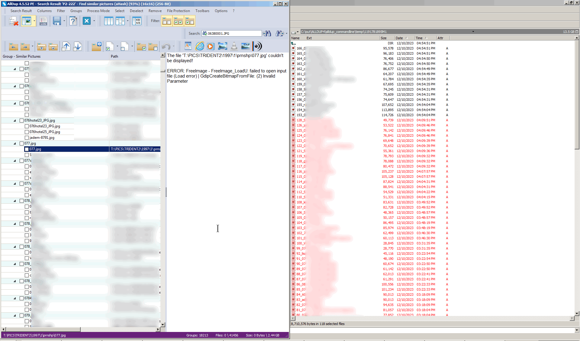

[on that note, the File thumbnails are generated in, read from /temp/GUID/
so maybe something in that area, between moving down a list, & generating
or re-reading (if existent) a particular thumbnail ?
i do not have duplicate thumbnails in /temp/.../ or anything that looks out of place
BUT... i only have 118 actual files (with a count of 128 - where i left off)
in this case...
124_ hotel23
125_ hotel25
126_ jadem
128_ stran_21
so 127_, never got generated, & if i'm rapidly moving down a list, maybe that
is expected?
AH,
i just saw thumbs NOT be created in /temp/.../ - when they should have been
above i had "stopped" at 128_. there was a break, 127_missing. with that,
messing around, going back to a file in the previous group, so prior to
Group 076hotel23, then arrow-key down, & was - for a time, able to duplicate
the issue, & then, whatever i did or didn't, moving up & down & back...
i couldn't, & then i thought if i look & see what happens if i go down to
the next group... at that point i started to see thumbs fail to generate
in /temp/.../. & with that wasn't sure why they weren't generated, so then
i just mess around, more & at this point don't recall, precisely, but back
up, then down, then up & down, perhaps only staying withing the "hotel"
Group, 1 above & 1 down, & nothing, then it was like, huh?, & so then &
proceeded down more, & at some point, thumbs then began generating, again?]

1. is showing a file (in the Preview section)
2. is showing Group thumbs (in the Preview section)
1. 077.jpg is actually the file ...hotel23 (in the Preview section)
2. is showing the correct "ERROR" message after having left-clicked on the 077.jpg filename (in the Preview section)
AllDup (& Servant Salamander displaying) /temp/GUID/ directory, showing thumb generation break, jumping from 128 to 153.
