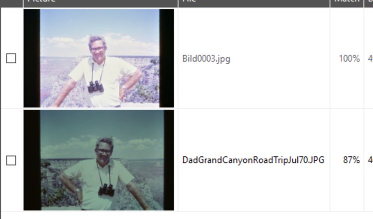

I just started using AllDup and it seemed to work but now when I compare two folders with known dups, it does not find any.
It looks like some of the pics are reversed, but this should not matter? I tried with various orientation options on and off.

i got this results with mHash:
Comparison method: mHash
Match: 80%
Detect picture modifications: Flipped horizontally
Re: AllDup not find dups
Thanks very much therube (glad the pics brought back happy memories for you too) and Admin (would not have known to use mHash).
