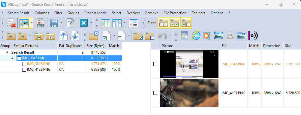

Uploaded two sample files from 928 available here:
WrongDuplicates.zip
https://www66.zippyshare.com/v/r0ikDvi9/file.html
Waiting for your insights!
Below is screenshot from AllDup 4.5.31 comparing them:

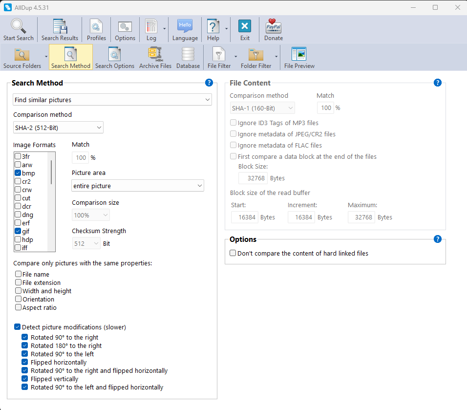

Comparison settings for screenshot above:
WrongDuplicates.zip

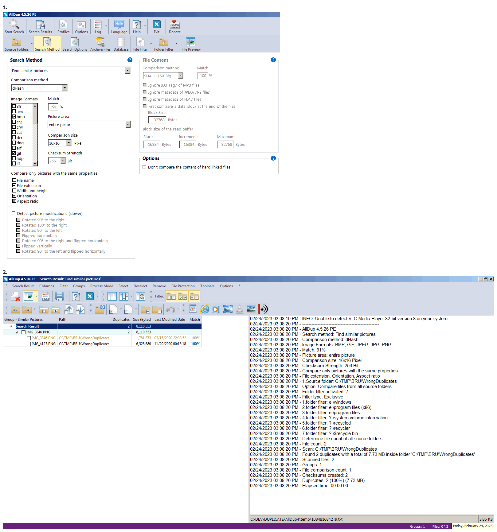

Re: 4.5.31 Bug: All mobile phone screenshots identified as duplicates
Well color me confused?
(I don't know that I've particularly run an Image dup search before ? & I'll assume these are default values?)
Anyhow, showing as 100% match, much less that it found dups, seems... odd?
