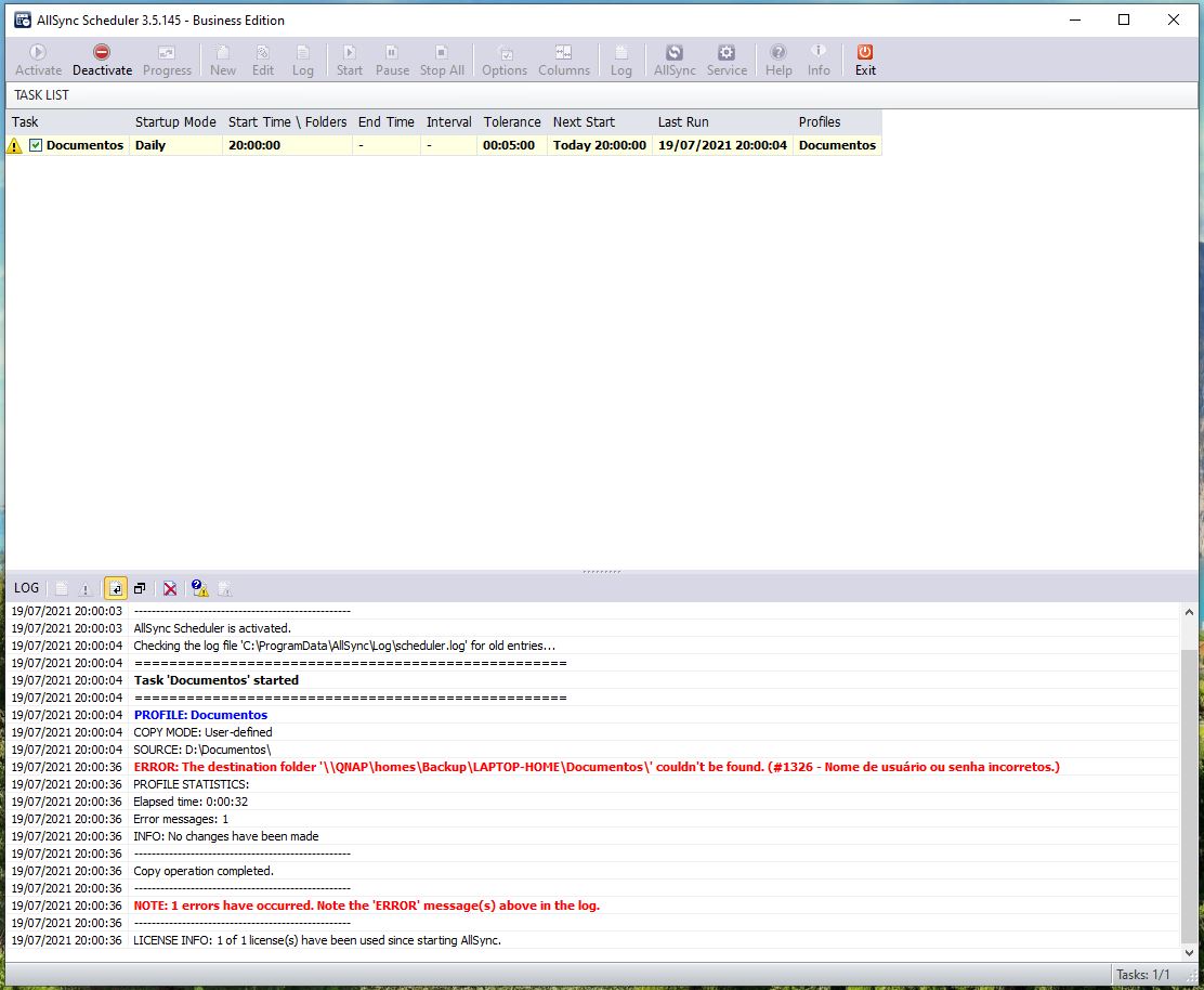

I'm getting error #1326 while copying a folder where it says the username and password are incorrect and the destination folder cannot be found. The network folder and path exist and the username and password are correct. I wonder why this error occurs. I appreciate anyone who can help me.

Destination folder cannot be found. #1326 Incorrect username and password

The windows error 1326 means: the username or password is wrong you have specified at the profile properties for the destination folder.

I didn't specify any username and password in profile properties and it always worked without a problem. But often, the message appears. When I copy, I copy the files that are on my computer to my QNAP server. The username and password it refers to is from my server, but I don't use it in profile properties. Does it have reference with Windows 10 Pro password? I'm in doubt.

I guess you have to contact the support of the QNAP server and ask why the access of your destination folder is sometimes protected by the QNAP server. Maybe they have a fix for this problem.
