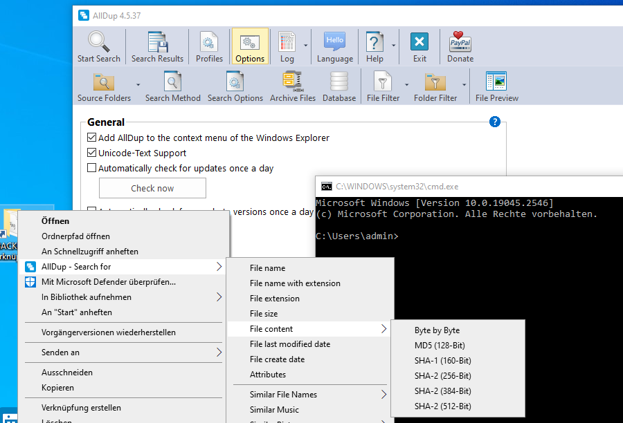

Re: Right click (Directory context menu) No longer appearing.
The FastExplorer files are from version 4.5.33 (or below) and not used anymore since 4.5.35.
We have tested version 4.5.37 on two other computers with Windows 10 and cannot find any problems with the context menu.
Maybe a fresh install with no previous version of AllDup installed will help.

Posts: 359
Don't know if it matters, but when you installed, did you install only for the current user, or for all users?
Might some other program that adds a context-menu item be interfering with AllDup's (on your end)?
